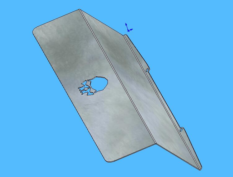

JS Manufacturing said:
Line inside with some high temp fabric stuff.
Trick of that will be finding something that will resist the temps / insulate without soaking up oil and turning into a giant lamp wick waiting to torch your truck.
Its not a problem if you don't plan on having oil leaks, but who plans on having them?

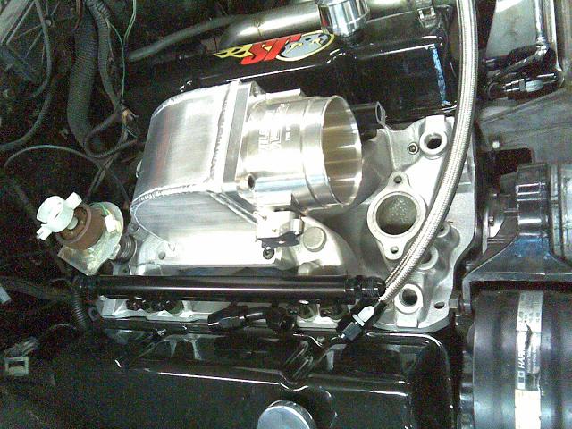

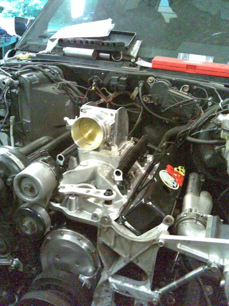

In between finishing up the last little bits for customers including stuff for George I have made some progress. Last week had pneomonia not sure how I got that.
Next week I start my new job, so now I won't have as much time but will have the money go figure.
Thanks to Nolan my throttle body showed up, started to make the adaptor, waiting on more aluminum to finish though.
Thinking of adding some heat shields to bolt to valve covers and go over headers. Line inside with some high temp fabric stuff.
Quit lookin' for things to fab and assemble the dang thing already. Sheesh.
Next thing you'll be fabbing custom tongue guards for the serpentine belts...

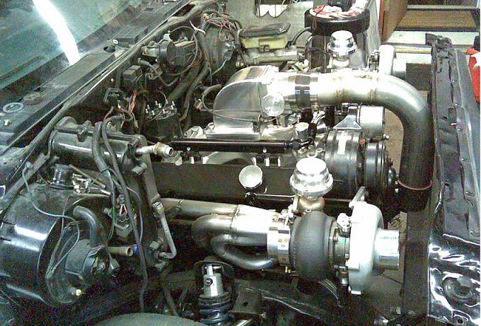

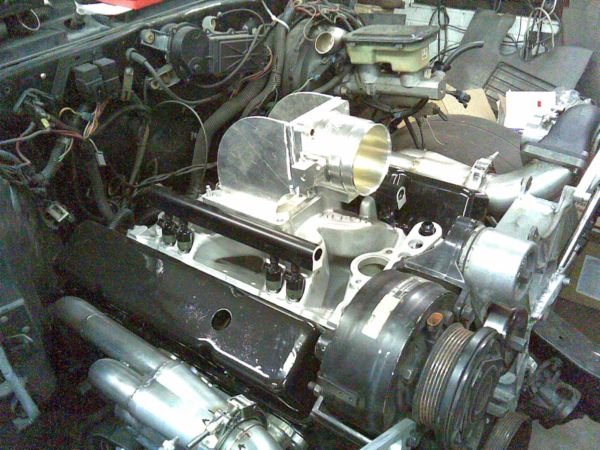

Re: Project Never Ends
Got more done today, even took a picture with a real camera. Figured I would just update picture above, instead of posting a new one.
The radiator is going to have to slide forward, but I think I have it figured out.
Inlet tube is closer, plenum has been partially polished, machined the throttle cam for TB, got the wastegate on pass side mounted, drivers side waiting on another flange to arrive. Headers are all done, minus modifing one tube on pass side.

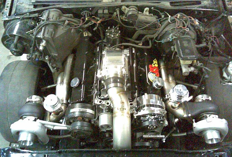

Last mockup picture, just after this was taken the motor came out for the last time so I could mount the front diff, finish the motor mounts. Both are done, so motor goes back in while the headers are heading off to get coated.
Got my throttle working also. The wilson TB's are setup for linkage style so I had to make my own cam for the cable.
