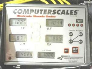

Did corner weights tonight. Truck launched very well at track so wanted to see what we actually had for weights on corners.
Without me.
With me
