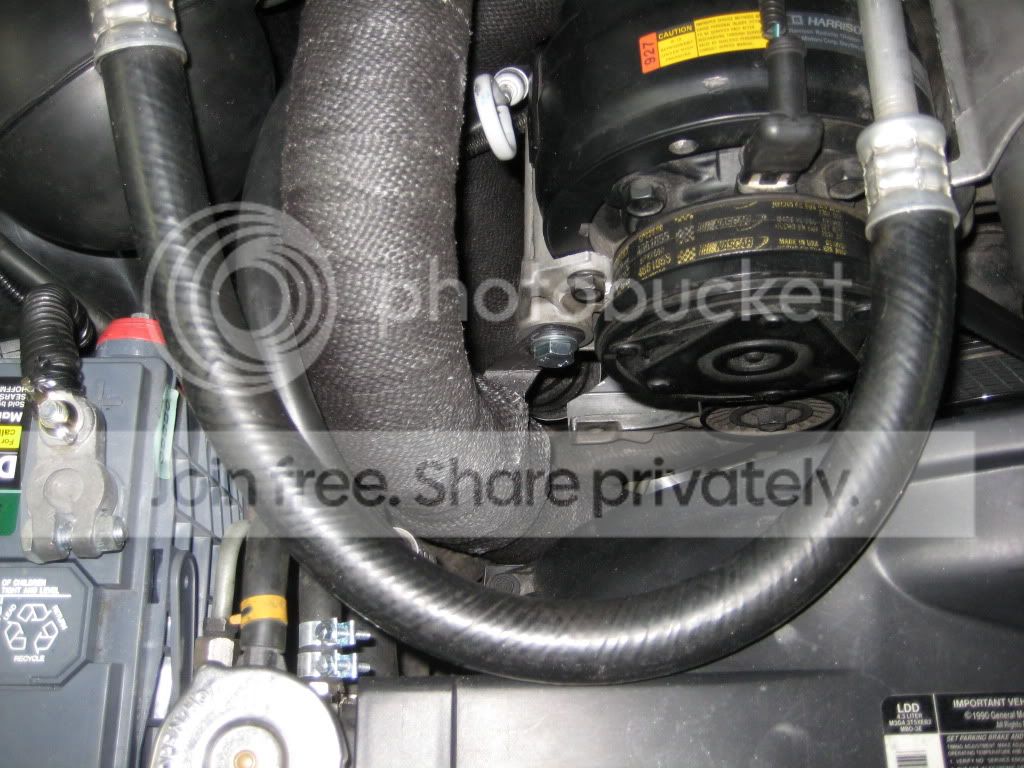

Buttoned up some things on the truck. Gave her a bath, and took her on a drive. Still tinkering with the BOV. Need to get on the freeway & do some WOT pulls. Working on an intercooler. Don't know if I will go AtoA or Water. Trying to find an air or water heat exchangers that fit between the frame rails. Barks the tires through the gears :D

Been a while, but got some progress done. Finished the intercooler setup. It's not very big, but it is 4" deep. Made a scoop to help capture the air. Wrapped the tubes to cut down on heat transfer. Got the supercharger back from repair. Bad bearings, I guess. Still waiting on cladding from the painter. Had almost 100 deg days in July, and some of the cladding warpped. It was installed with some looseness in the upper puck area, and it was warping from the body. As I was trying to re-fit one piece, it cracked. Maybe drivable by next weekend.

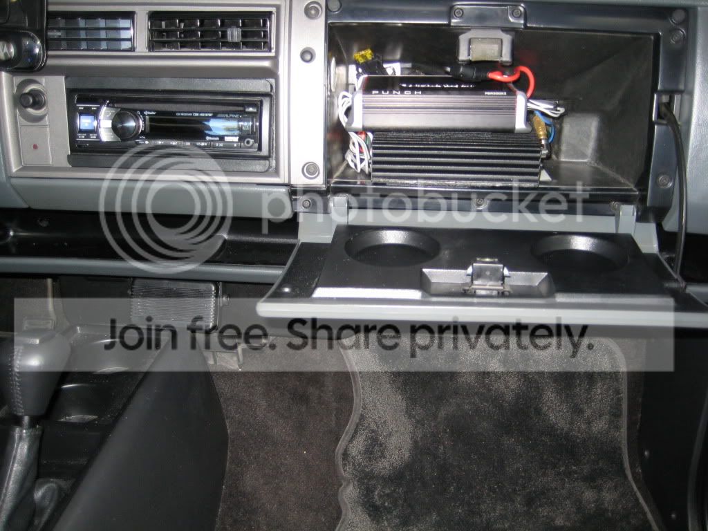

Then the old Alpine went out. No switched power for amps, or antenna. Faulted it to the power board, so I'll keep an eye out for a cheap functional unit & change out the board. Went ahead and put in a new front amp along with a new Alpine with HD radio. Don't see paying for satellite when I drive it so infrequently.
