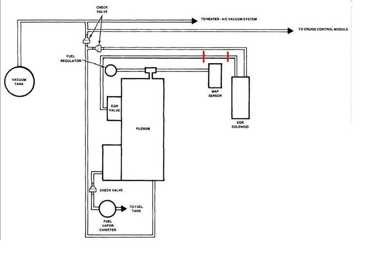

I got nothing as far as vac or boost goes. Just tried to hook autometer gauge (red marks) and got nothing. I can't even feel but maybe a small amount of air. Is that right?

Ok I routing through the fuel reg line and it works. The truck hits 10 psi for a couple secs and then hit pegs 14psi and thats when it seem to not go awaywhere. Tranny?

wait a sec.. are you saying that you T'd into the vac line that goes to the fuel pressure regulator for a boost gauge?

Actually to the MAP sensor. I plan on redoing it later. I just needed a quick setup to check my boost.

I think I read somewhere you shouldn't T into the MAP because it will change readings it gets and effect performance, that why everyone ties into the brake booster line. I could be wrong but you might want to check into this.
What he said
