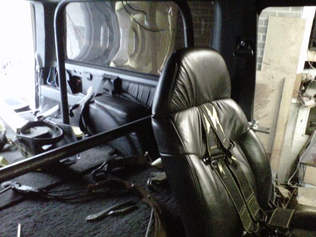

Cage is tacked up, having never done a cage before I am learning as I go. Also learning what a ty takes to make it work, what fits best, etc. Bent 3 main hoops before I liked what I had.
To be legal the cage must tie directly into the frame, so I had to drill holes in spots that let me access those areas, which is also near the body mounts. So the rear bars go down right in front of gas tank to body mount, the rear bars go up then turn to go forward still allowing back seat to be used.
The main hoop is tucked near the ash trays, with bends to match the body line fairly close. There is a removable (not NHRA legal) rear bar that will swing so people could climb in rear seat with bar in place. I also have 2 extensions for door bars with swing outs clevis's. I have not done the door bars yet though.
Once I am happy with everything buy door bars I will drop the cage down to weld the tops, then lift it back up into place for the last time and start attaching to frame. Door bars will be last so that they swing and latch as they should.
You can also see the drivers seat which I modified to accept the 5 pt restraints. I think it came out very clean, when you remove them you can't tell the seat is anything but stock.
