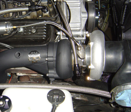

you need to paint or powder coat the jsm skull on the intake pipe

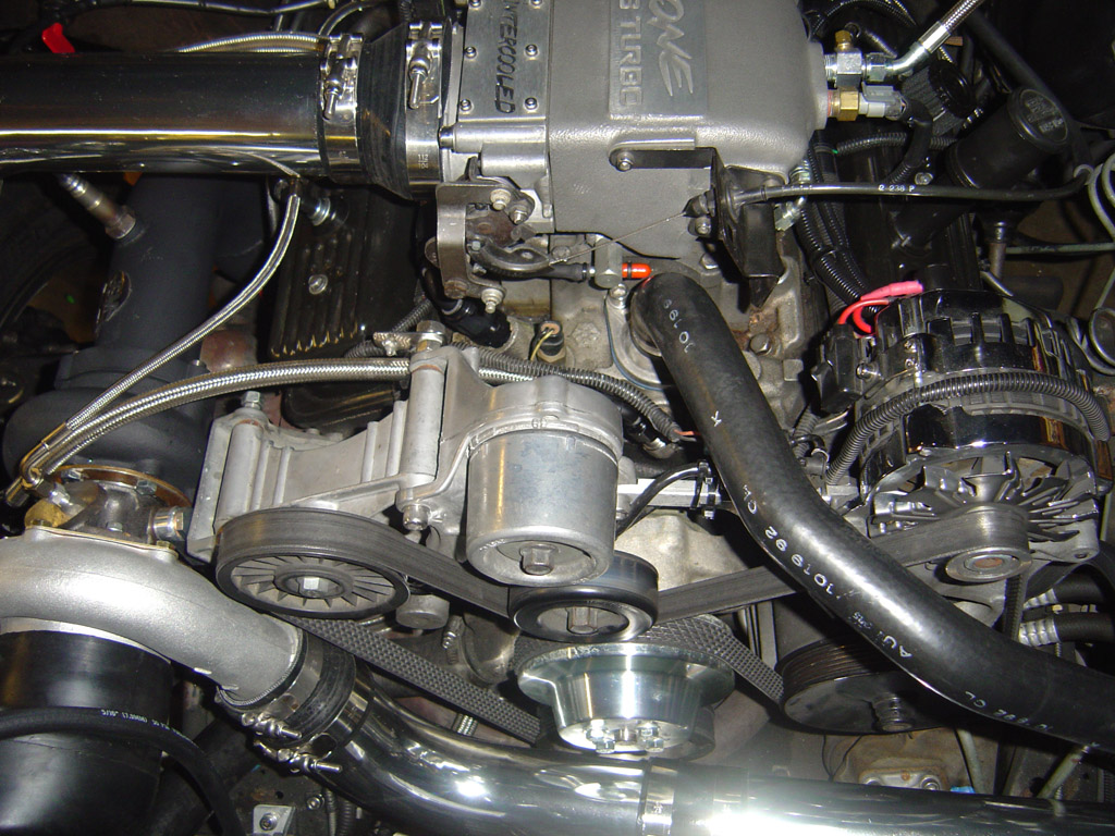

Just cleaning up all the wires and looming everything would make a big difference. I have all the wiring on mine and some things moved around and you can see how it cleans it up.
Before Air to Air - Wiring
After Air to Air
I would also probably get the DP's Ceramic coated Black and then polish the JSM skull like I did on mine. Looks dang good that way and stands out.
Downpipe
The more you can move and hide things the better. Makes it harder to work on sometimes but really makes it look good.
