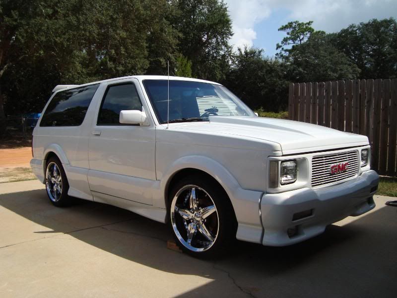

Oh, and here is a pic of the truck from yesterday. I love this truck.

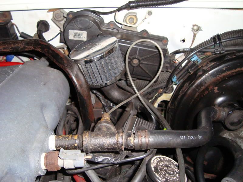

And here are some engine pics. Not the cleanest (yet), but it runs well and I will have it ticking away like a sewing machine in no time.
If anyone has suggestions for what needs to be done, I am all ears. I am familiar with LS1s, so this little 4.3 is all new, and I have no background at all with turbos.

You have a really hot manifold near the pump/reso on the driver side too along with a really hot x-over pipe that crosses underneath everything as well.
You wont be able to track down a "new" ZQ8 per say, but if you look on here, we got guys who sell them at a reasonable price. You may want to search on "jeep steering shaft" while you are at it. Both the shaft and box swap will make your truck handle 100x better than stock and rid most of the slop.
So how is your truck controlling boost with the boost solenoid not even hooked up to vac?
You may look into swapping those metal IC lines for 3/4" hose. Instructions and some other helpful info can be found here: www.sytyarchives.com

I just ordered the steering box and the guy who had Ty before me already did the Jeep shaft. I have no idea about the boost, but it seems to hold 15 lbs., if that even means anything. I am a complete noob with turbos and such. While I catch on quick, the learning curve on these trucks seems to be nearly verticle. The ty is not my daily driver, so I can take my time with learning my way around it, hopefully avoiding costly mistakes.
He has a MBC
leadfoot
Re: My First Mod
No offense but you have some ugly "plumbing" coming out of your upper intake:lol:
Ha-seriously some Home Depot parts in there lol :rotf:
Looks like the solenoid is by-passed in favor of a grainger valve. Supposed to be reliable.
Ya, I know. I am thinking about the silicone hose kit one of the vendors on here sells, but I don't really know if it will help this particular issue. I have alot of hose work ahead of me and because of my hose work in the past I am going to work around the kids schedules. I am going to be babystepping my way through this one. I also have to get a high flow IC pump since it still has the stock one and look at doing the metal IC line delete mod. While I have everything apart I think I am just going to go ahead and do the steering box at the same time. I just put the shifter cable in yesterday, but I got the Dormon before I researched it and the fit is less than spectacular. I am going to have to massage it around the HD propshaft. Oh well, live and learn. I have spent alot of time in the archives and have some ideas for what I want to do. Now to get the money together to start all of these projects.

The piping that goes from your intake to your brake booster is pretty ugly. They did it for a boost gauge is my guess. I would hit up Rpm (vendor here) and get one of his braided pieces. The work great and look great. oh and another thing, I am not a fan of your wheels.
