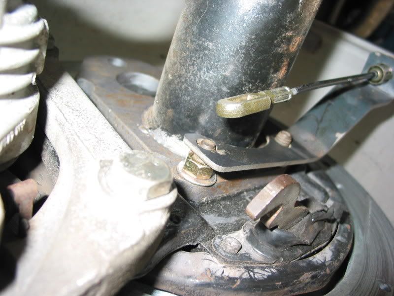

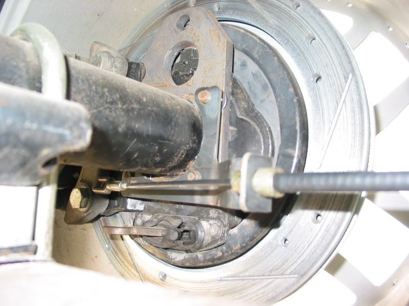

I went out for some pics and would have to argue that this cable fits no syclones . I was looking forward to installing these but couldnt figure them out any which way. I will also check the ty later with pics as well , but for now ...
Hits on the small end and at the hump it gets bigger . Should work with some dremel action .
Bracket puts the cable at a good angle
Maybe with a twist you would have it perfectly , but I dont feel its a must do .
Cables are side by side the whole way
Unless you wound the cable up to fit this clip in the hole , the shielded portion is too long
The cable itself has along way to go until the connection
Even on the other side , the unshielded cable portion has to have some good length.
I'll send everything back to you mike , Im not doing discs on the ty even if they were to fit one .
based on that pic, i think the design/cable angle are good. Does anyone involved in the group buy have any issue with the look/function of this bracket?
