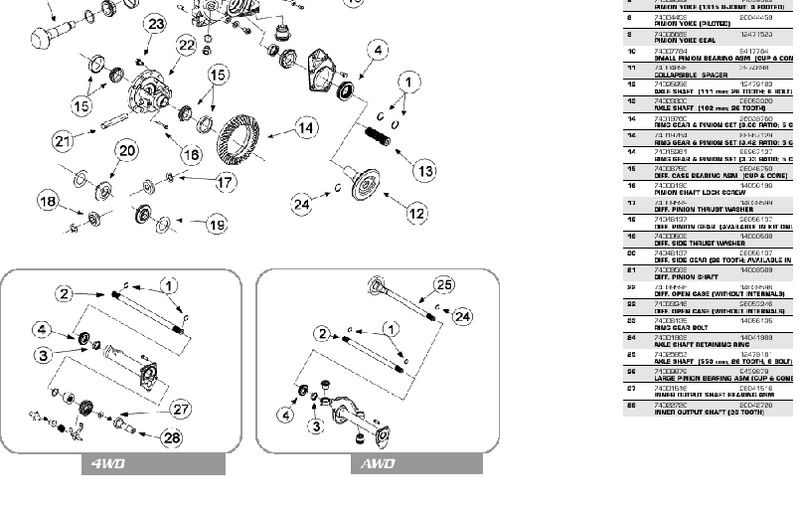

My part number came off the bag the snap ring was in when I ordered it from GMC. When the GMC dealer pulled it for a 91 Sy the GM # was 14041989 . So I dont know about GM Part # 344171.
Yes its not the traditional snap ring with the holes for pliers. It works more like the snap ring on an impact that holds the sockets on. Its more like a piece of spring steel that holds the axle in.
I'm pretty sure your not the only one cursing the GM engineers. I have many times and sure I will for many more yrs.
When I ordered the snap ring I would try both part #s. Might be just a cross referenced # but you dont want to end up with the wrong one. I took my old one with me so I could eyeball them together.

Well according to that chart I posted your part # is it. I have to py before they order so i'll check again.

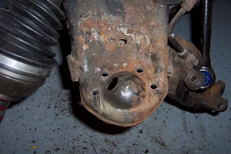

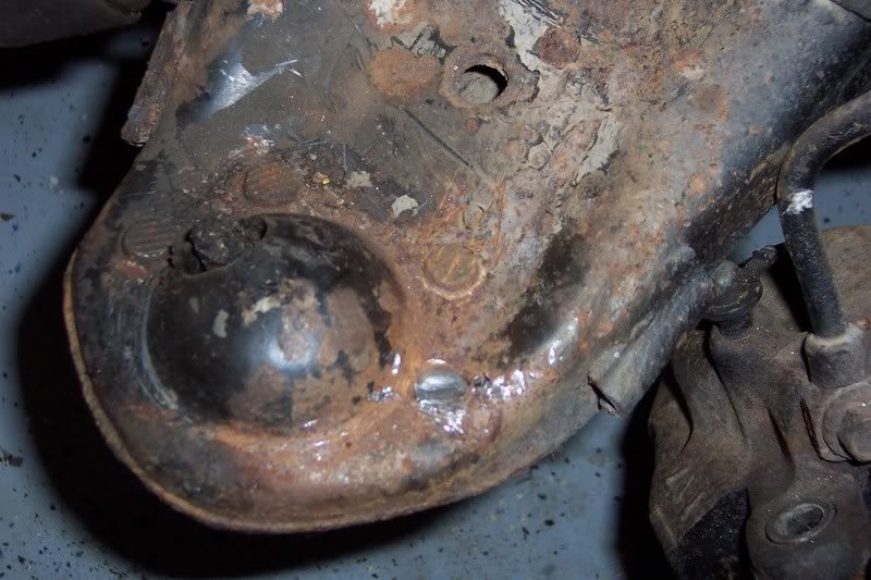

And for the lower ball joints.....
Used a grinder to get most of the head off the rivet, then chiseled the rest....
Then I took a hole punch and started pounding down what was left with a punch and.....
New one bolts right up.
*now I've added key words like ball joint in hopes that when someone searches they'll find this useful.

I used an air chisel to shear mine off and the to punch out what was left. Easier than grinding, but if you dont have an air chisel a grinder is next best. Let us know when you finally drive it. Hope alls fixed. If your luck is like mine it'll never end. I just put a Sy rear and front diffs in my Braphoon project and I hit a chunk of steel today running abour 75mph ruining a brand new Nitto 555 285/40ZR-17 dented the drive shaft. When I put my spare on it was flat. Finally got someone to air it up for me and it wobbles like crazy. Well, I put on another rim and its not the rims, must have bent the axle somehow. Just put it in 3 wkend ago. So My 4th will be putting in a new rear axle shaft. It never ends. :banghead:
