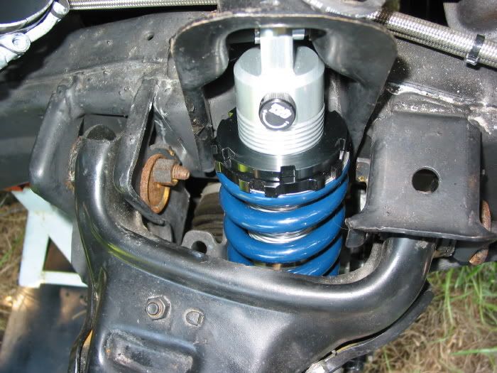

I am buying one of the qa1 shocks and 2.25 I.D. springs that mike uses in his front setup . After looking at my friends rpm front setup , I see what needs to be done .
I am o.k. with modifying my upper arm and reinforcing it . To me this is no different than the ls1 spindle mod . When it arrives I will be getting right on it .

modifying in what sense? would you have to cut it to fit the spring in, then reinforce the arm while working around the spring?

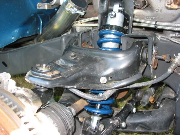

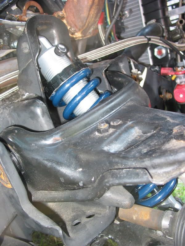

I see 2 possible spots to modify . One for sure is opening up the insides of the upper arms , and then reinforcing it hopefully from the inside so it looks undercover . If that isnt enough to fit everything , I will have to move the lower arm shock mount to where it allows clearance .
Between the shocks , springs ,more por 15, paying the sand blaster and welder , I doubt I will have 600 into everything .

Best bet might be just slightly relocating the lower shock mount. I think I may try konis. I need something that's gonna hold up. I drive my truck too much.

That snot a bad idea . I will see if I can get away just modding only 1 of the 2 arms .
I really didnt think there would be a problem using the qa1's , since I would end up with them anyway if I plunked down the 1500 for either of the 2 companies kits . I did look into some other shocks , but for the money , the q's cant be beat . Also , the stock arm mods should be the same with konis , qa1 or (insert favorite here) given the shock and spring dimensions from one brand to another are close .

Passenger side is done .All I need to do is make some spacers to hold the shock in place , and flip that bolt around .No touching anywhere during the full range of motion . Now to get my tune in order ....

sweet what did you have to do to make that fit, I cant wait for a write up!
