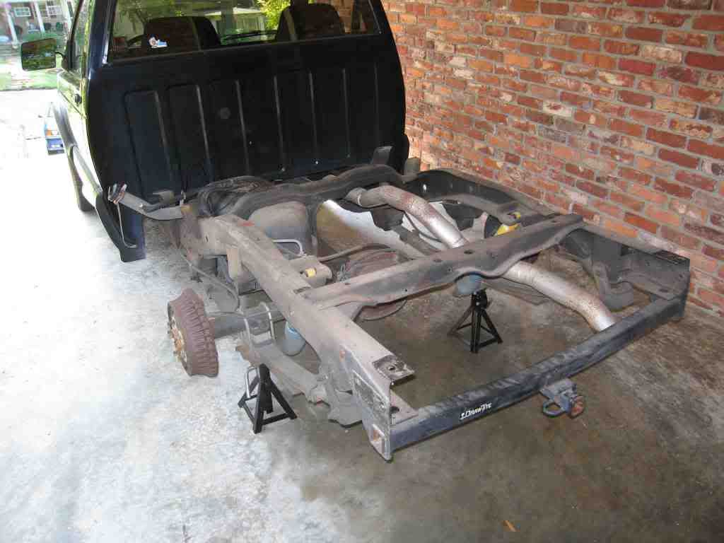

Ahh...I forgot to mention...pulled the bed and replaced the fuel pump 2 summers ago with a Walbro from RPM...stock injectors...and 2 year old fuel filter. Issue predates fuel pump and filter swap.

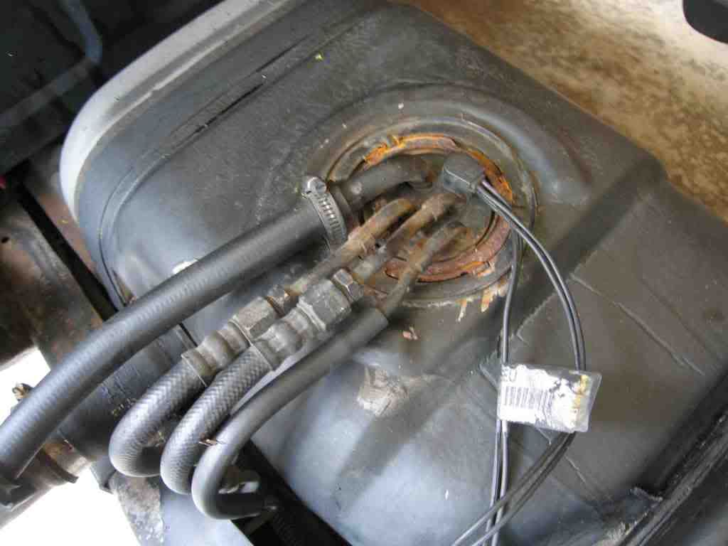

"did you change out the fuel pump wiring harness inside the tank ? my guess is the connectors are shot and build resistance as everything in the tank get warm . does the truck have the stock catylitic convertor on it ? this could be the issue also ."
Ahhh.... I did not change out the fuel pump wiring harness!...just cleaned up and replaced pump and filter. There was also little union connector (black with gold bumps) allows fuel line to couple inside the tank. I used what was in the kit from RPM and that little union connector did not go back in. It may be a kind of bellows. Photo below...I left it out and dont think it matters, my problem was there before/after pump changeout. And I did throw it away I remember now, can get a new one if needed. Luckily I took a lot of photos during the Summer 2010 restoration,
Now as for the wires...to be certain. Are these the wires in question, see image below. Would I just swap the connector with new and splice the wires in further upstream? There are no wires inside the tank that I remember, just connectors. All looked visual okay inside the gas tank Summer 2010 when I did the swap.

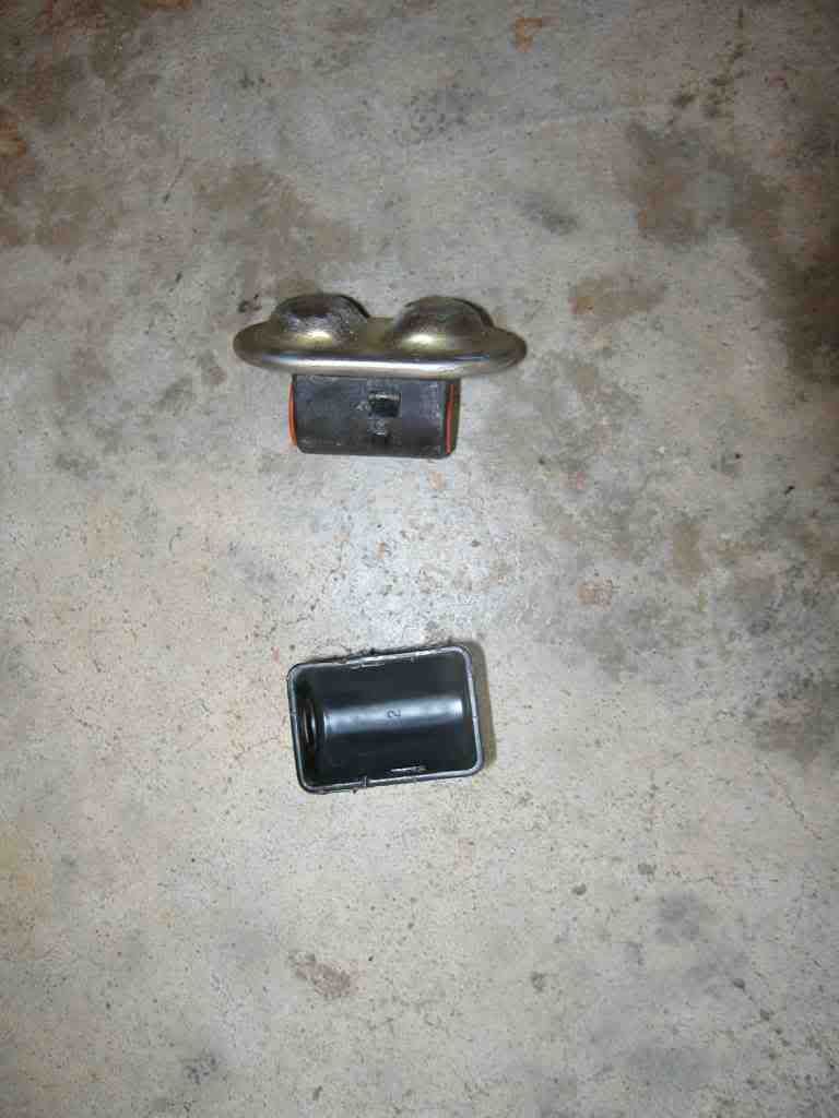

The little thing with gold bumps is called a pulsator,it take the shock out of the fuel line.Some trucks will get a knock count with out this.Is the any chance you have your inter cooler lines mixed up and maybe drawing from the top port instead of the bottom?

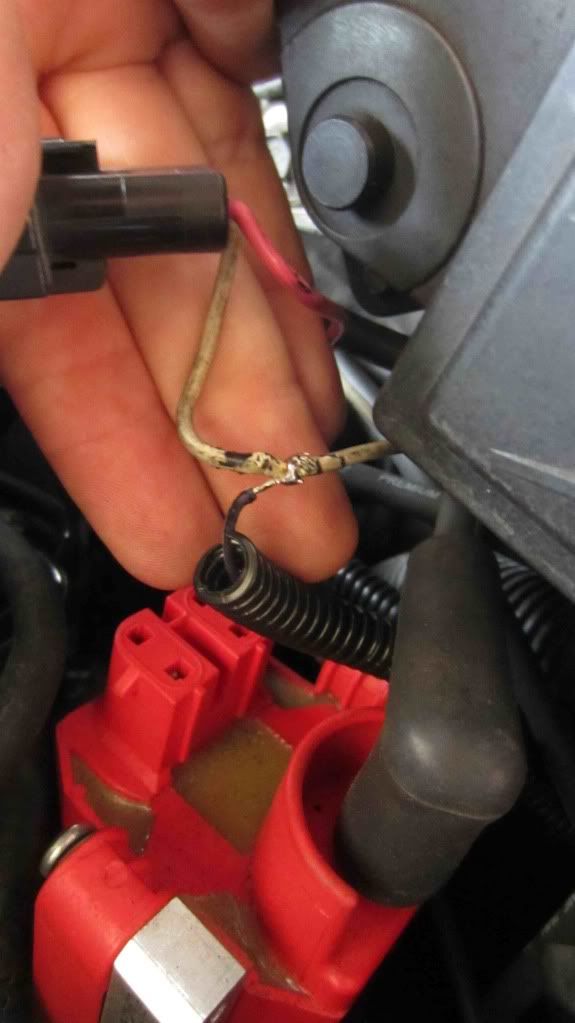

Don W, I checked the ignition coil wire.....the white and pink all look good. Now there is a spliced wire in there for a Viper remote start. Picture below. It's not the prettiest but I think the connection is good. I black taped it up again after the picture and secured it. IF, this is a major concern I could cut it out and redo the connector. Thoughts welcome but think I'm okay. When it's cold the coil and the engine "seem" to be running fine...I have not yet thrown out idea completely of replacing coil again. Will attempt datamaster files in next post below, and hopefully it'll help in the mystery...
