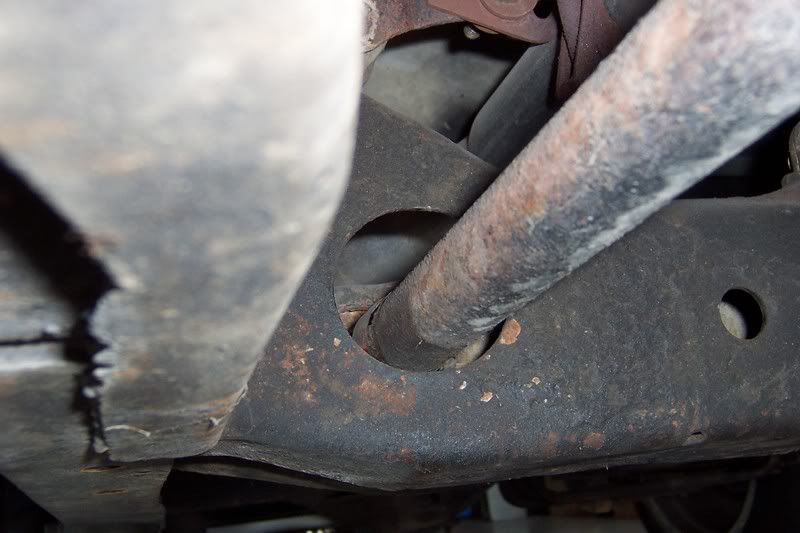

How in the hell do you get the cross member up high enough to get the mounts out and new ones in? The torsion bars go through a hole in the frame and don't give enough room to clear for removal and install.
I've searched and found some crap or knocking out a pin, removing the ride height bolt, and dropping that "porkchop" looking thing down....but I can't see how that helps my situation. I removed the bolt but haven't tried knocking out that pin.

I can't lift the cross member high enough. The torsion bar hits in that hole and won't clear room for the new mount. I even have the short stud on the new mounts.

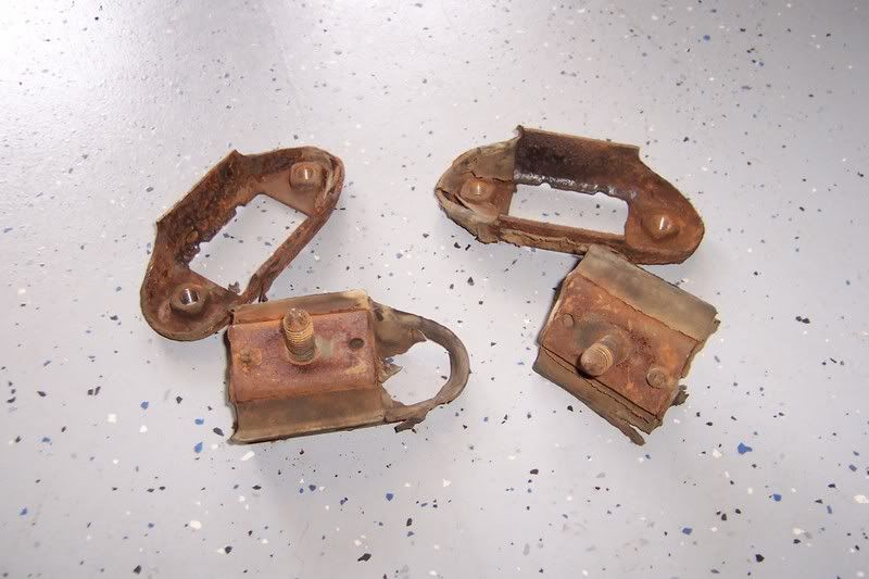

Old Mounts

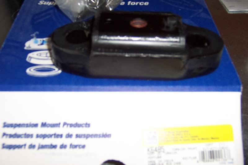

New Mounts

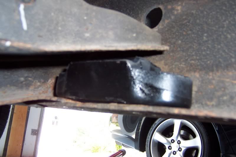

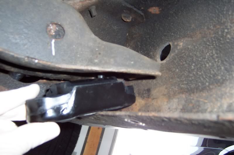

The problem!
Jack up the cross member and the new mounts slide right in. I even lowered the truck back down and all the bolt holes lined right up.
Now the results.....I have ZERO NOISE!!! WHoooohoooooo!!!!!
