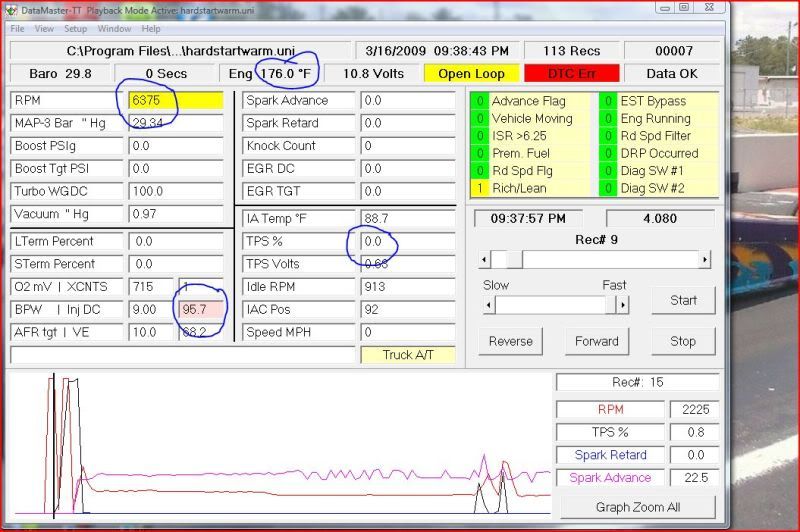

DM shows the engine at 6,000 RPM's while cranking when it's hot and it just dumps fuel

took a screen shot of cranking with the engine hot. not the tps position, enging rpm, and injector DC. This is while cranking only when it wont start

Holy crap, this problem followed you to this truck. I remember the 6K rpm issue from before. Have you logged a cold start? to see any differences.
The reference signal for rpm is getting f'd somewhere along the line and its down hill from there.

Ok so I've had this issue with 2 different Ty's, 3 different engine harness', 3 different ign modules, 2 different ECM's, 2 different magnetic pickups, with and without MSD 6A etc. Only thing I didn't compare was stock dizzy vs MSD since they are a bitch to change. What would cause the egine to see 6350 rpms while cranking hot and flood the engine? Low battery voltages?

Very interesting observation. My DM screen shot shows 10.7 volts to the ECM while cranking. They may be too low to fire the igniton adequately. One time when I had this issue in a parking lot I had to get jump started. As soon as I had the jumpers hooked it fired right up. Maybe the added voltage helped??
