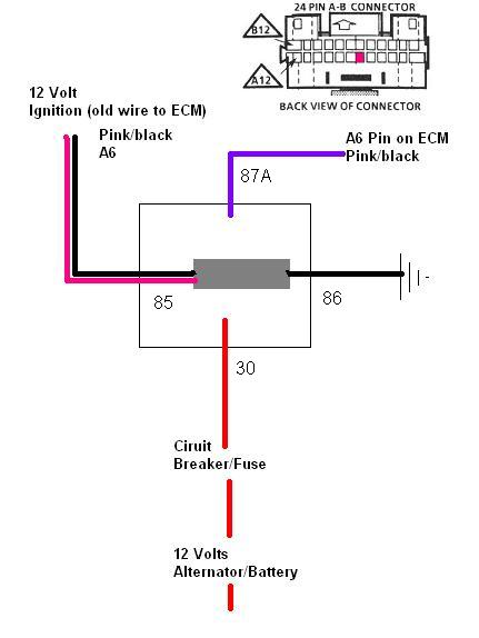

This has been mentioned a few times before. I just did this mod today trying to resolve a tuning issue in my ty. Although it didn't solve my issue it did raise the voltage at the ECM by 1 volt which surely can't hurt.

Its nice to have a diagram finally for this mod that a lot of people have done.
What size fuse would be enough for this application?

Great diagram. I had E-Rue's old post saved but a diagram makes it so much easier. I bet this is a hell of a lot more effective at raising voltage than "upgrading" to a 140 Amp Powermaster..

Be careful. The diagram shows "87a". You actually want "87".
87a is normally closed. 87 is what you want. Most lower amp relays don't have an 87a anyway.

This is a great mod... I had issues with my ECM voltage dropping to 12.1 at WOT and I did this mod and now I get a steady 13.8 to the ECM. Definitely has to help and it certainly can't hurt. :tup:

What's the purpose of this mod? I know it raised the volatage..but why? what problems can this solve?

This mod (ECM Power Mod) gives you alternator voltage (higher) at the ECM as opposed to the stock setup which gives you battery voltage. It keeps a more consistant votage right at the ECM. Helps for some and some notice no difference. Most see an increase of 1+ volts at the ECM in datamaster. The way our ECM is wired there is all 6 injectors running off of one injector driver in the ECM. There is another mod to split the load across two injector drivers and therefore cuts the duty in half. >>>CLICK HERE<<< This link describes how to change wiring on the ECM to split the load on the injector drivers C12/C10 (yes it works for a stock truck).

Battery voltage SHOULD be alternator voltage. What happens over time is the wiring and connections build up some resistance and that cuts down on the available voltage at the other end (ECM). Using the relay eliminates this resistance. So really, we're not "boosting" the ECM voltage, rather bringing it back up to spec.
I'd be reluctant to use a circuit breaker in place of a fuse. C/B's take longer to trip, and that could mean the end of your ECM if something is pulling too much current. A fuse is safer.
