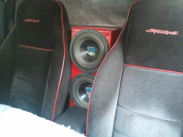

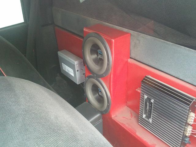

Looking to redo the sub box in my Syclone. It's a very odd box that sits partially behind my center console. The new subs I have are about 2 inches deeper than my existing ones, and I will need to make the room somehow. Pic for reference:
My preference would be to slide the console forward to accommodate the speakers, rather than start hacking up the center console. Was wondering if anyone has ever tried this, and how it worked out.
I'm thinking it would most likely need a different length shifter cable, but I'm wondering if there is anything else I'm not taking into account... because there is ALWAYS something I didn't plan for lol.

I'm way ahead of you on the gear. The stereo was this way when I bought the truck, and redoing it has been on my list. Shallow mount subs kit too soft though. I already have a set of Cadence 8's (rms 500W each) and a Kicker ix 1000.1. Haven't picked a headunit yet, but it will be replaced as well. The changer is going in the trash.
As for redoing the box, I just LIKE the design of it. With the seats up, I think it looks pretty nifty.
(Ignore the red vinyl, that will be going away)
I cursed at it at first, but it has grown on me. I really do not WANT to hack at the console. I think sliding it forward is a much better solution, and I think it should work out alright. I just want to be prepared for any hiccups I can anticipate along the way.
