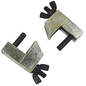

Just to clarify. When you have a gauge hooked up, you energize the fuel pump, gauge shows 42 psi, de-energize pump and pressure slowly drops? If so, grab a pair of hose pinchers (or vise grips) and clamp a rubber section of the return line. Repeat the pressure test and see if pressure holds. If so, regulator is allowing fuel by. If it still drops, either the pump or the injectors are leaking down.....or you didn't tighten the pincher tight enough.

Energize the pump from the test port (spade socket near the trans dipstick - stick a wire in there and touch it to the junction block to energize pump) for an easier way to do it all under the hood. Try the clamp technique and see what happens. Clamp line, energize pump (will just barely have to lay the wire on the junction block to get the pump primed....don't leave it hooked up), and observe pressure behavior.

With the only thing he changed is the AFPR then he needs to go back there. The pinch return line is a good test but it's difficult to tell if you've, in fact, squeezed the line clear shut. Be ready for fuel to spray when you do this.

If you can't clamp the return line shut with hose pliers, then you need your mechanic card revoked. And where is the fuel spraying at? Pinch it, check for leakdown, unpinch and let system depressurize (which won't take long if it's leaking down like the OP describes).
